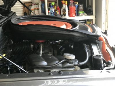

Why don't you just raise the rubber seal up to your hood bottom so it will seal?If that's the VIS then its not even close to sealing. However it did seal quite well on the factory hood w/o dual scoops. Ill say this though with the larger cowl the vararam sounds so good.View attachment 209692
I like how yours has that barrier around it. That would be very beneficial to me to help prevent rain water. Where did you get that lower portion from?Why don't you just raise the rubber seal up to your hood bottom so it will seal?

Not sure what lower part you're talking about, mine is a Vararam just like yours.I like how yours has that barrier around it. That would be very beneficial to me to help prevent rain water. Where did you get that lower portion from?
The snorkel is exactly what I was referring to thanks.Not sure what lower part you're talking about, mine is a Vararam just like yours.

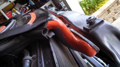

I had to build up the rubber trim to meet the bottom of my hood with extra rubber, but if it's the orange snorkel you're referring to I made that myself.
Mines an 03 and they don't make the "Air Grabber" for my year so I had to kitbash mine to make it work.

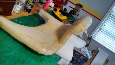

Made it using Styrofoam as a mold.
