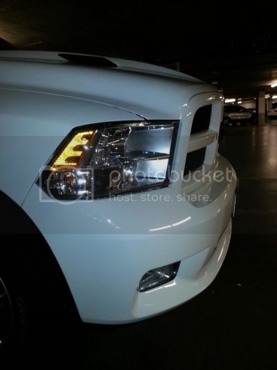

I think his grill to bumper gap is ok it looks like his light is crooked?

The guy at the dealership literally told me what do you expect you bought a dodge and that was their fit and finish quality.
I'm so mad at that dealership let me tell you.
Here's a pic:

I still think that's how it's gonna look as long as the headlights are aligned right. But I completely understand your frustration. But, it's a beautiful truck so don't let something so simple bother you.

Looking at it I get a impression that it is something to do with the lights but It could be just everything that needs to be realigned aswell
