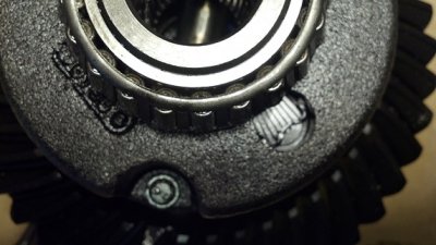

Here is a factory trac-lock also called a carrier. In the one photo you can see the clutch discs that like to fail. Also one of the retaining clips that break.
