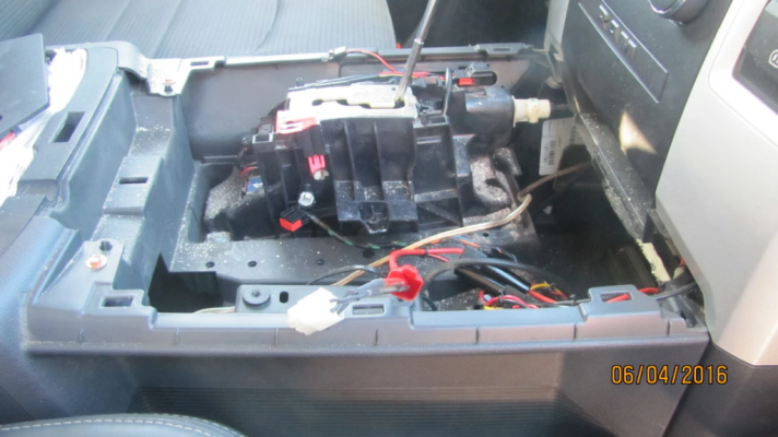

I am guessing here,
you must have a 2500 or 3500 Ram ??
Having the Shift handle already on the steering column, make the conversion much easier.
The only thing to think about, would be where the wires will be run.
Disconnect the Battery
Just unplug & unbolt both the drivers & passenger seats
Then lift the armrest on the console, unplug the cigarette lighter & other wires.
Remove the rubber mat that is almost against the dash board, pop the plastic parts off.
Unbolt the console, be careful of the wires & any module on the transmission/driveshaft tunnel.
I looked at a place in OHIO for the parts, but they think their parts are made of precious metals.
Look around eBay, etc.
it should not cost more than $250
Your console will sell for almost twice that
your present unit will not have the shifter or many of the wires
