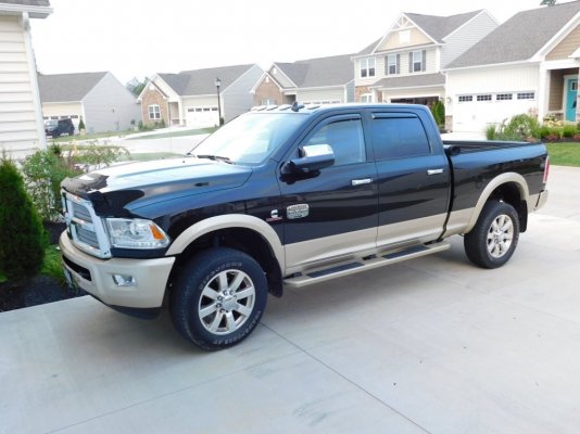

I Ran my 2010 Ram hemi 155K without any engine problems. Changed oil at recommended interval. Everyone has different experiences with their trucks. I loved my 1/2 ton, but upgraded to a 2500 with Cummins when I purchased a fifth wheel RV. What a great truck! Sorry to hear of your expensive problem.

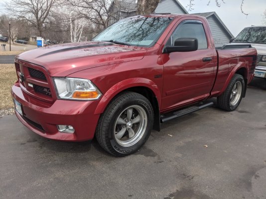

I love my 2012, but remember if you have auto start don't let your eng. idle to long because you will run the possible chance of destroying your Hemi !! My 5.7 has had the oil and filter changes every 3000 mi.
With the best oil and filters available, but still at 134200 mi the eng cam and lifter problem showed up. Now I am going through the process of a new 5.7 replacement. 7-9 thousand replace cost. So be very careful and listen to your best mechanic about your 5.7 Hemi!!!
