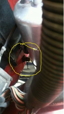

My 98 had the same thing it was where the ac drain came thru the firewall i added a drain tube and sealed the hole also the radio antenna gromet sometimes leaks these are photos of my 01 the locations should be the same.
Radio antenna and ac drain line [with hose installed].

Thanks! I'll look today and see if that's my problem! I appreciate the input!
