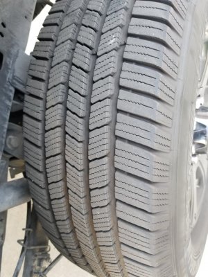

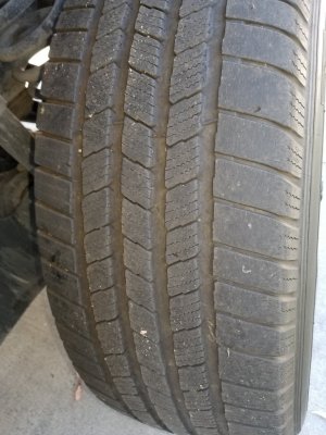

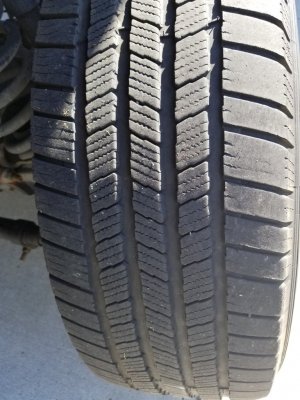

I have a 2" lift on my front end. It's a spacer on top of the coils. I have gone to 3 different shops now and had 3 front end inspections. Every time i have also gotten an alignment. It has been way out of alignment each time, and I also JUST learned that my rear end is out of alignment too. That is causing a constant pull to the right, but according to them that shouldn't wear my tires. Once i get a handle on what's going on with my front end I am going to take it to a local alignment center that knows how to align a solid axle. I have just gotten in my 5100 bilstein shocks that I will be putting on this next week. Going to get it aligned right after wards to see what will change. The worn ones are my front tires. The good tire is what it should look like. The wearing in only on the outer wall. When you look at the tire you can visibly see that the camber is off. Does anyone know of one specific component that could cause this to happen so often? I have only been doing highway miles. If this doens't work then i will be forced to do a front end rebuild. 20181118_123932.jpg 20181118_123915.jpg 20181118_123941.jpg
