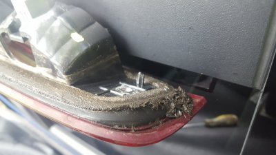

Then I noticed smaller wet spots in both rear corners on the headliner...pulled the 3rd brake light and noticed the gasket was caked with dirt and debris and there were water marks on the housing behind the light fixture. Also noticed the drip rail over the rear window was completely blocked with dirt.
Using a screwdriver I scrapped out all the crap...and up until 20 minutes ago, I thought I resolved the problem.

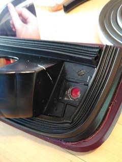

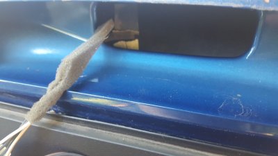

Below is a pic with the 3rd brake light removed from my 2017. That groove or ridge you see behind the light, in the roof structure is what I believe channels the water to either rear corner of the truck. The white crap you see was someone's attempt to stop the leak before I bought the truck. :(
Here was my attempt at fixing it..

PoMansRam- i cleaned it up about 2 weeks ago, need to replace it but didn't have the time then. Also cleaned the housing behind the light at that time too.
Just took the light off again today...and I see more water marks back there. Obviously there is water getting behind the 3rd brake light.

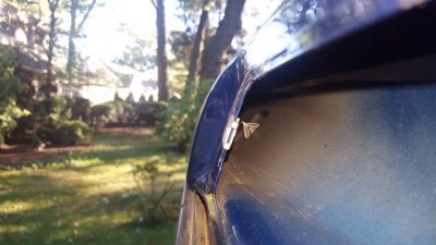

And here's the channel where the water is using to get to the corners...
So frustrating to have such a nice truck but it smells like a swamp for a week after every rain storm.
