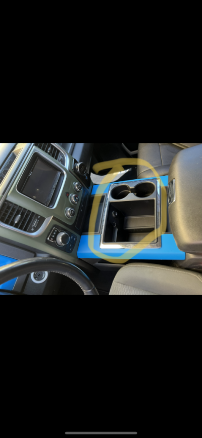

I’m doing some things and need a longer bolt but don’t know what thread this is. Every other thread is a different size. I can just drill it out and use a normal bolt but was hoping to just find this bolt at 2” or 2 1/2” long.
It’s from a center console.

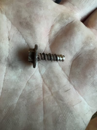

Looks like it is threaded for plastic if that helps?

Any self tapping screw would probably work.its plastic so a regular course thread sheet metal screw would also work.if you ever went back to stock just use a shoter version of what you get

Ok perfect thank you

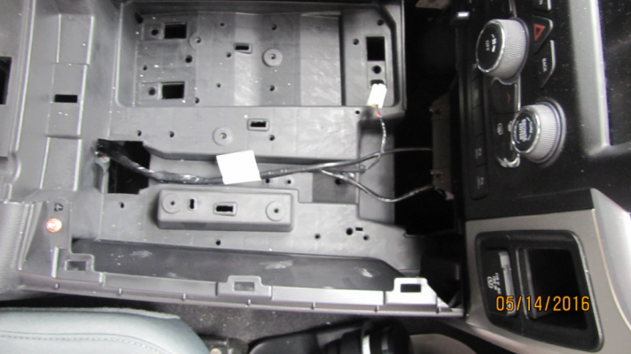

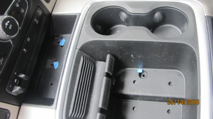

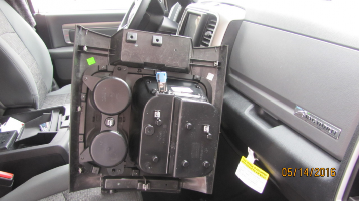

I am not positive, but there is one screw in there that is Gold Colored.
I have thought that it might be a GROUND Screw
each piece of blue tape, is where a screw goes
The one by itself is the gold colored screw
the blue plastic is the cigarette lighter

If you are wondering the technical name of that style hardware, it is a thread rolling screw especially made for brittle plastics. The particular style is very common in the automotive industry, although not unique.

Thank you. I’m a pipefitter and work with steel so I never come across this type of fastener.
