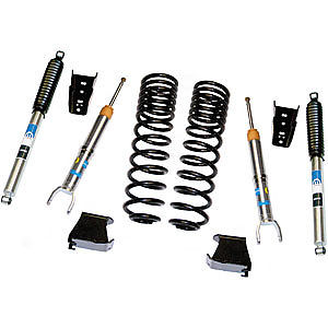

What are these brackets for Mopar Lift P5155797?
Koko
Mar 24, 2013
189
30
Dudley, MA
Now I know everyone feels these kits are overpriced. I actually don't think they are. If you figure a set of 4 Bilsteins cost about $375. Then layer on a set of icon 1.5" springs for $280 that's $655 total. Now there's 4 additional brackets that are included. I have no idea what they are for. Granted $245 is a lot for brackets. But there must be a reason they added them into the kit.
K
Koko
Mar 24, 2013
189
30
Dudley, MA
After looking at the Superlift 4"...I believe the triangular barackets are for the sway bar. To relocate it lower. The other brackets are bump stop extensions for the rear.
