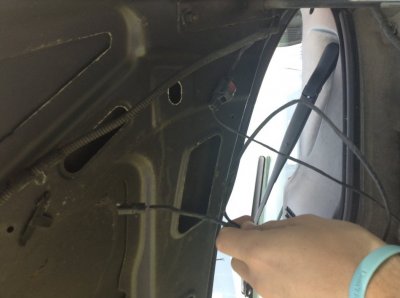

What are these wires on underside of hood
Rippinlt
Jul 30, 2014
2002
4.7
I know the one is for the engine bay light. What's this stray wire? I was thinking ambient temp sensor because I can't find the sensor and my LCD says it's 150 degrees outside.

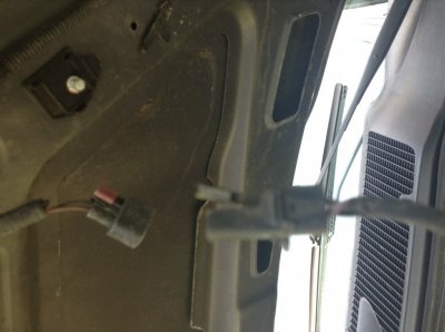

Photos won't stay in correct orientation
R
Rippinlt
Jul 30, 2014
2002
4.7
Plug

no idea on that.
the ambient temp sensor is located where you see the circle in the pic below
credit to HemiLonestar
dodge dude94
Millennial Boomer
Sep 5, 2013
27,745
6,429
East Texas
1998 Ram 1500
5.9 Magnum
I'd be willing to bet it's for the ambient temp sensor. It's located on the hood on 02s. I'd also be willing to bet that you're also missing the underhood lamp.
