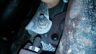

Just found a broken bolt today. I was kind of suspecting it for a little while now but I finally got under there and looked. I'm heading to the dealership Monday to see what they say. Here's a picture.

Just an update, went to the dealership yesterday and they replaced the bolt without hesitation. I still have the factory powertrain warranty.
