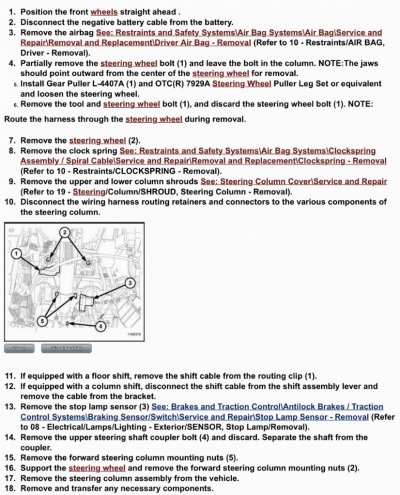

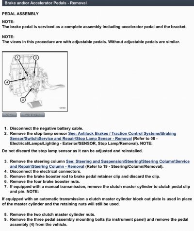

Am I gonna do the pedals? Probably not, as they’re perfect where they’re at for me, and I would never use it. For those that truly want to do it, it’s pretty much a direct swap. I was wrong about needing a harness. I have a tradesman and looked up under the steering wheel, and everything is already there. The pedal connector is plugged into a dummy plug by the pedals, and the switch connector is wrapped in foam by the steering column.
Parts you need:
Pedal assembly- 04581692AF
Switch- 56046113AA
Remove steering wheel (plenty of writups and vids on this) and steering column-
Remove the existing pedal assembly-
Install new pedal assembly. Cut appropriate size hole in lower panel for the switch to snap into. Reassemble everything and plug all the connectors in. Using AlfaOBD, go the VehicleConfig 3 and enable adjustable pedal feature, and you’re all set.
