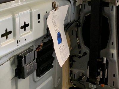

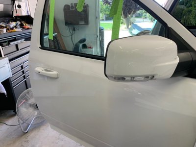

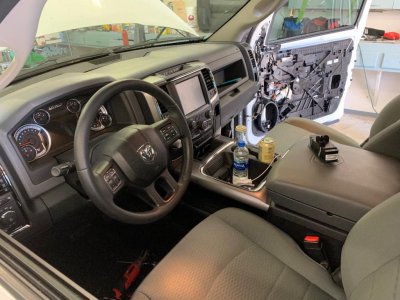

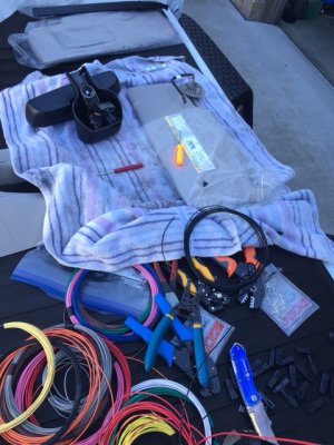

Purchased my 17 Ram Regular Cab Tradesman new and since have added many factory options to it. Cost is not so bad compared to buying the truck new with the option from the factory. I think the time to research, purchase parts and install the options correctly is a challenge to me and kinda fun.
Here is what I have done so far: "with a bunch of help from many on this forum"
POWER FOLD SPORT MIRRORS
LIGHTED SUN VISORS
GARAGE DOOR OPENER
AUTO DIM MIRROR WITH SMARTBEAM AND UCONNECT
LEATHER STEERING WHEEL WITH AUDIO CONTROLS
PREMIUM GAUGE CLUSTER
8.4 RA4 RADIO WITH NAVIGATION
CENTER FLOOR CONSOLE
CONSOLE MOUNTED CD PLAYER
PASSIVE ENTRY WITH PUSH BUTTON START AND ALARM
GLOBAL WINDOWS DOWN
REMOTE STARTER
FOG LIGHTS
LED SPORT TAILLIGHTS
I know there is more that has been done and more waiting to be.
