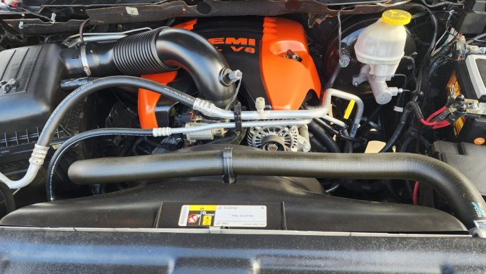

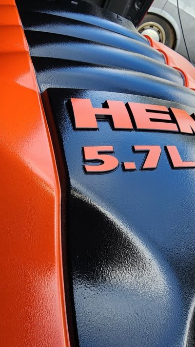

I thought about doing something similar. Looks good. What kind of paint did you use?
Duplicolor adhesion promoter, VHT paints and clear. very high temp paint isn't needed, as the engine cover doesn't get heat soaked like an engine block, but I had the black and clear, and wanted the paints to be same formulations, plus VHT makes a HEMI orange.
I shot a satin clear, but might go back with a flat clear, to knock some shine out of it, so it blends in with the rest of the bay

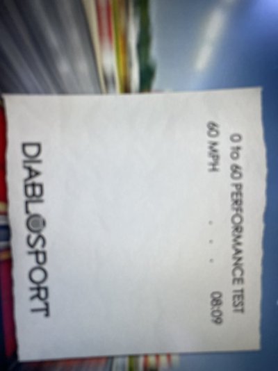

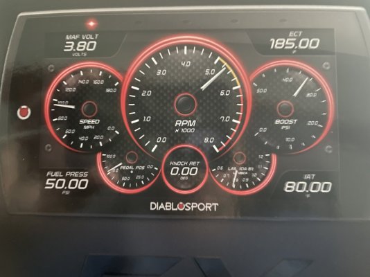

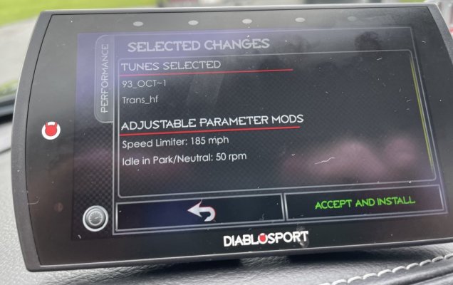

Finally was able to do some testing this week. Since I installed the tuner and downloaded Hemifever tune, nothing but rainy weather. Glad Sean was patient with me, as being computer savvy I am not.IMG_2028.jpegIMG_2029.jpeg

Still a little slow. I realize a 4 door 4x4 Laramie is no speed demon. However either fall or next spring I will add a cam, heads and exhaust. Don’t want to be slow when the twin turbo weed wackers want to red light race.
