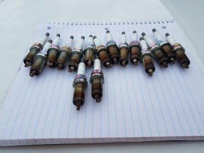

Did not unhook the battery. 57253 miles. Runs noticeably smoother and way better throttle response. I'll be doing it every 35k. I was very happy with the mopar plugs pre gap. Very consistent. The notebook picture is oriented as the top being closest to the firewall. I have closeups of the plugs too

Thanks for posting that up, to be honest I am under 20k on the truck, but I'm 6 years in. Have the plugs and the gap tool, so I will do the same. I run a fuel cleaner that has lubrication oil, so I really want to check the plugs and see if there are any cylinders with gunk that others don't have. When I pull the plugs I will have 8 paper cups labeled so I don't mix them up. I'm gonna likely just get a cheap boroscope, so I doubt it will have capability to video.
Are those plugs 57k miles? How old is the truck?

truck is a 2013 laramie longhorn 2wd with no previous records of service so i can only assume they are the oe plugs therefore with 57k miles on them. im anxious to run a couple logs and see how they look.
