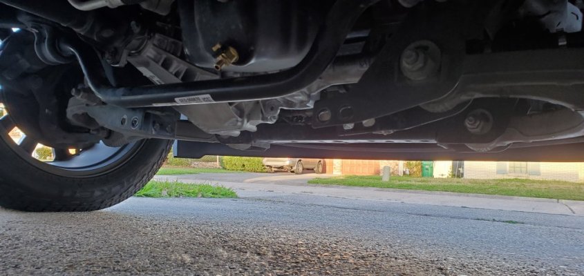

What is this called and is it safe to drive back to the dealership?

Just picked up my truck for some front axle work and the tech forgot to install a crossmember. Is it safe to drive back to the dealership about 15 mins away?

Without that crossmember tying the front control arms together, every time you hit a bump or go over a dip, it's flexing the frame mounts the control arms are tied to. They are NOT designed to be flexed that way!
Do not drive the truck, and also request that their frame shop certify that the frame is both still structurally sound in this area, as well as not tweaked. The torsional moments applied in that direction would be pretty bad, as that crossmember is not holding those two points rigid.

as mentioned, have them TOW it, once fixed, to a frame shop for verification the frame is structurally, good to go, and properly aligned.
You did drive it home, correct? so who knows whats been done to that frame. DOubt you went 5mph the entire way.

I'll agree with the have it towed back. If the cross member bolts back in nothing is tweaked or bent out of shape.
Don't worry about it unless they can't get the cross member bolted back in.
