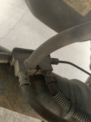

I have a part on my truck I need to replace, I can’t find anything online that looks just like it so it’s hard to tell. But I believe it’s a rear proportioning valve. New to working on my truck so I just want to make sure I get the right thing.

Axle vent hose with the side to side brake fitting in it?

As mentioned. That is a brake line. With the axle vent. I just replaced this on my 03 2500. Got it at advanced auto.
