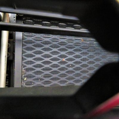

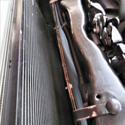

HP can shut off the code on the 4th Gens,not sure if it can on the 5th Gens though. I just ran with the middle ones removed,as a hot day here is 90F,we don't get very many days approaching a 100F. I also ran my homemade bug screen which kept the condensor and rad clean of bugs,as i think alot of over heating issues can be traced back to dirty /plugged condensors and rads.
Do you have any more pics of that screen? I know Genos Garage sells a screen for the HD trucks and I've thought about getting one and trimming it to fit...
Jan 17, 2016
23,877
54,971
14 Sport
Not to many more Corey.I used to make and sell them,then sold the patterns to a welder who was gonna make them,and he lost the patterns. They bolted in at the bottom and used push pins at the top . Mine was showing it's age,as it was my original 1,and it had been on 2 trucks,it needed a repaint,or a powder coat.The fine mesh screen was replacable,as i made 2 frames,1 that the corrugated steel mesh was welded to,then another frame that bolted to it,and held the screen door screen in place.They fit both 6 speed and 8 speed trucks,as they went behind the shutters on the 8 speed trucks
I quit making them as it took me about 4 hours to make each one,and about 30 bucks in material/welding costs,and nobody wanted to pay a 100 bucks for a bug screen ;)

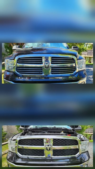

I found swapping out the restrictive Sport grill to the more open/better flowing Honeycomb grill made a differance in temps,especially with the majority of the shutters removed.Personally i think the Sport style grills are garbage,as they don't let enough airflow through to the rad/condensor.
Yeah i was blown away at how restrictive the Bighorn/Sport Grill is compared to the honeycomb grill. This is when I was swapping the grills out looking through the air intake cutout.
