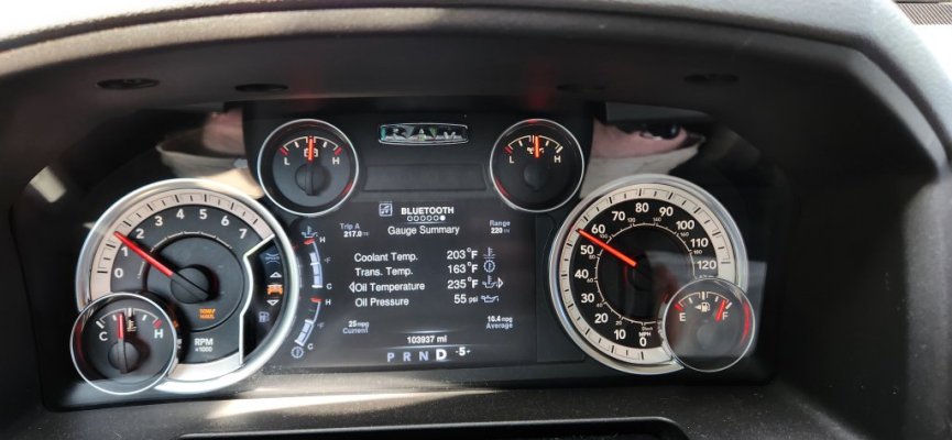

First time towing with the Calorstat 190. VERY impressed with it so far. This is the hottest my truck got after pulling a long grade up a mountain. Outside temp was about 80F.
Thanks Corey, simply amazing. There are so many lies about thermostats. look at trans temp, eventhough trans is higher meaning working harder, engine oil and coolant temps down. All you did was tune fan start temp and add a t stats? And this is towing heavy. Should be a sticky.
You got to post other test picture of old temps.

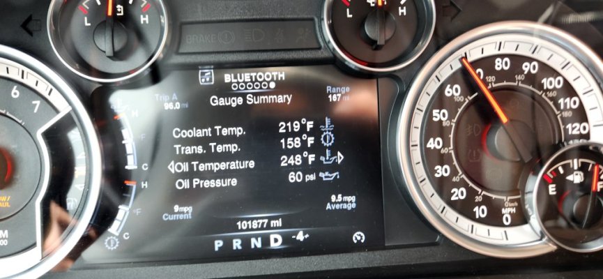

Sorry cell service is terrible where I am now i could only upload 1 pic per post. Here's a screen shot of what it was in April in Virginia on flat highway. It was 90 out then vs 80 yesterday but I doubt 10 degrees made this much of a difference. This was with the Mopar 203 tstat.
Mods since then are the Calorstat 190 tstat, used OEM honecomb grill, and lowered efan temps using HP Tuners.

As you can see the oil psi is a nothing burger, just represents his speed he took the pic at. Clearly eventhough working harder better temps.
