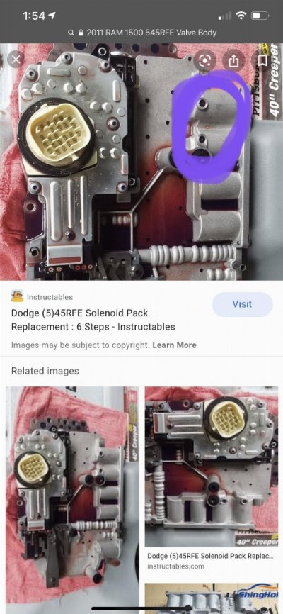

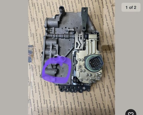

I just may have found my issue.
I looked online for a 65RFE valve body and a 545RFE valve body as my mind was telling me to look and see if there’s a difference, and i think i just found out what’s wrong
I MAY have got the wrong valve body. I don’t know if they’re compatible, but i notice a few things that are different, such as:5d3f45c1dd70f0eac15d08ba459e5150.jpg
My original valve body doesn’t have the two black dots on top of the accumulators that i can only think of as being bleed off valves. Could this be an issue that i need to take up with the eBay seller?

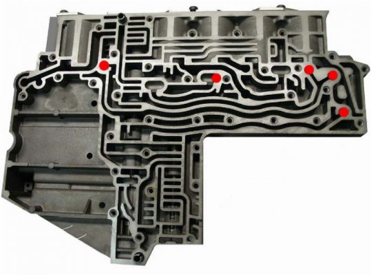

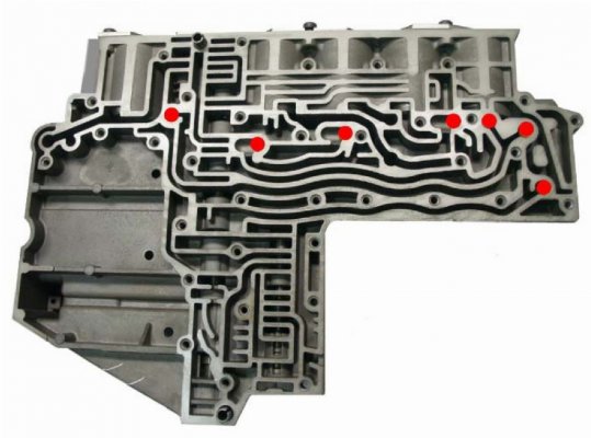

You can use a seven-ball valve body in place of a five-ball valve body, but not visa versa, here.
So a 65rfe/68rfe CAN be universal with small mods, but not a lesser rfe.
Then they go on to say this, and I'm at a loss to be honest, lol..
If you are not sure what valve body you need for any RFE transmission just install a seven-ball separator plate with a white solenoid and you can’t be wrong.
Basically they recommend using a seven-ball on the upgrade whether your solenoid pack has the seven-ball or five-ball.

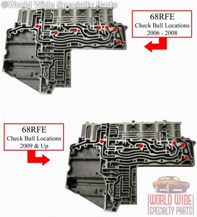

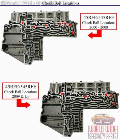

This was my concern with the 545 versus 65, but as you can see, for some reason the 545 has the check ball locations.

Same, the check ball locations had nothing to do with what rfe, but rather build date.
