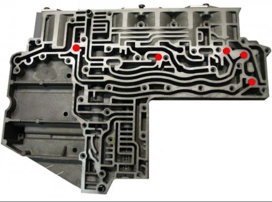

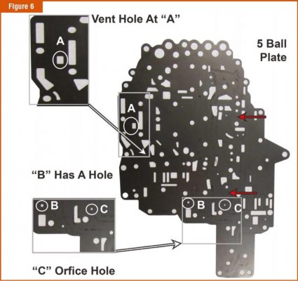

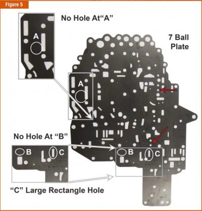

This is the last post i’ll be making on this thread, as my truck is acting normal again. But to sum it up for people who may have been experiencing one or more issues that i have, here you go:
1. 7 Check Ball Valve Bodies DO NOT WORK with a grey solenoid pack, only with a WHITE solenoid pack, which you can install in your truck if you bought a 7 check ball VB instead of a 5 check ball VB by accident.
2. There are differences between a 545RFE Line Pressure Sensor and a 65RFE Line Pressure Sensor, And if you install a 545RFE line pressure sensor you’ll be stuck with a constant “P0934: Transmission Pressure Sensor Circuit Low” fault code.
3. You can tell the difference from a 7 check ball VB and a 5 check ball VB with these 2 images (listed below)
5 check ball plate, (2009 and up). Notice vent hole above “A” in the plate, and the other differences, of course.
This is a 7 Check Ball VB, notice no hole at “A”, no hole at B; and at hole C, there’s a large rectangle hole.
Bad image, but these are the locations of the check balls in a 7 check ball VB. bcac47983aceabef229c832fcedda9e7.jpg
Check ball locations in a 5 check ball VB
Lastly, MAKE SURE TO CHANGE YOUR TRP (TRANSMISSION RANGE PLATE) WHEN YOU CHANGE YOUR VALVE BODY!
Sent from iPhone XS Max
