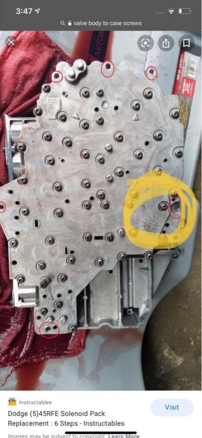

This is the screw that broke, would it be okay to leave out?

Oh boy that sucks....
Your best bet would be to get another from either online or the dealer. I would imagine those have specific threads and tensile strength.
Does the new valve body come with new screws?

The new one didn’t come with anything except the solenoid pack and the vb itself.

Damn. Well looking at the location of that I think you would be ok to leave it out for now....

Yeah, i looked at both sides and it looks like it’s not gonna interfere with anything, and the VB isn’t budging on that side either.

You should be ok. The ONLY concern I would have with leaving that out would be warpage over time....

Great point, i have a new tranny pan on the way so when i’m down there im gonna replace the bolt. Deep pans for the win.
