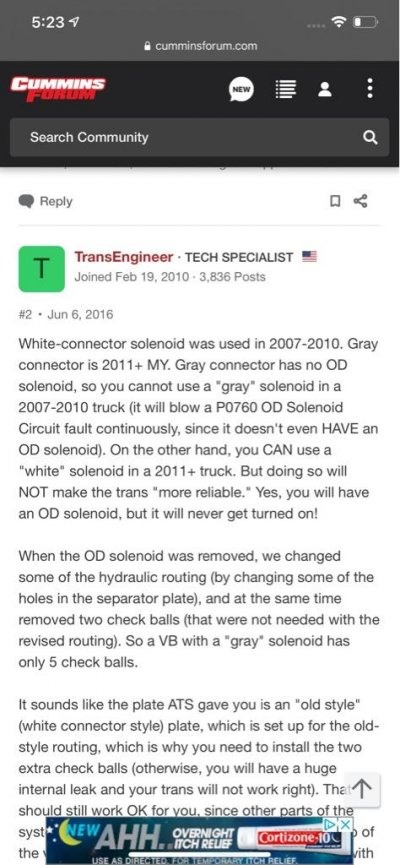

Sorry for the bother, but i just read this, even though it’s for a diesel truck: 4cea18bdecd3caa91f6c0f08368b65ec.jpg

You can replace the gray-connector solenoid block with a white-connector solenoid block, as long as you use the right transmission range sensor plate: Type 2 with cars that have manual 1 and manual 2 on the shifter, type 3 if it just has Drive on the shifter.
link. So I'd use grey if you can find it close in price, I don't understand the other bull crap price structure, is grey that much more from your guy?
For some weird ****** reason the price is 220$ more than the white one from the person im going through, i think i’m just gonna bite the bullet and go to o’reillys for the white one and get the new TRS.
