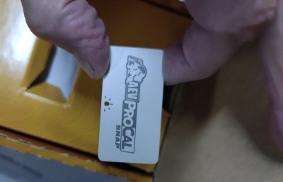

yes i have corrected mine via procal. I have verified both speed and and tripmeter with 2 garmin gps. hand calculation is within 2/10s. I know you will probably say not able to use the pro cal snap but I was. E721DE80-8EEE-4AA6-B79A-54F32DF3FA38_1_201_a.jpeg

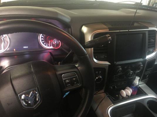

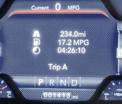

I'm averaging 12.2 MPG but that is some highway, some towing, mostly in town. Min is 100% stock with 4.10's. I have gotten just under 17 MPG hand calculated on the highway averaging about 67 MPH. Could probably hit 18 if I slowed down to about 57 MPH. Towing 9000lbs I get about 8.5 MPG.

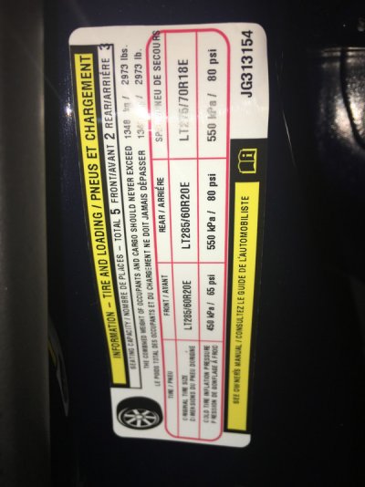

But, if you want to tow 12,000 lbs better get a 3500 if you want a Cummins or you will likely be overloaded. The payload is so low on a 2500 Cummins that the 2500 Hemi will usually out tow the diesel if you are concerned with being legal. Forget about towing a 5th wheel with a 2500 Cummins. Almost guaranteed they will be illegal once you pull out onto the road.
And I read you said something about the Hemi having a knob for a shifter? Maybe I misunderstood that but not sure where you got that from? My Hemi has a shift lever on the column.
Diesels definitely have their place but if you don't NEED one they are a waste of money. It would be foolish for me to buy one. My boat only weighs about 9500lbs and my 6.4 tows it great. A 2500 Cummins in my mind is a waste of money because the payload is so low anything you can tow or haul with it can easily be done with a 6.4. A 3500 Cummins would be great if you were towing anything over about 12,000 lbs but having 1500lbs of tongue weight would push the payload limits of most 2500's once you load up your passengers, bed, etc. If I had that heavy of a load I would definitely buy a 3500 Cummins but anything less and I'll take the 6.4.
Oh, and here is my payload:

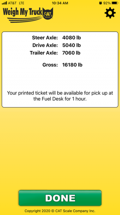

And here is my son's 2018 2500 6.4 towing his 8100lb travel trailer. Truck was 9100lbs with the tongue weight. Would have been very close to being over payload if he had a Cummins
It appears you have a 4th Gen for one and for two, all the new gas 2500’s that have the 8-speed have the knob as well. Only the 6-speeds have the shifter on the column.
