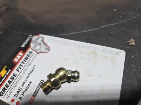

Again, it's almost every newer fitting, regardless of whether it's a bushing, ball joint, u-joint, or tie rod.
I notice that older zerks are pretty round, newer zerks have a ridge towards the bottom side, shaped a little more like a bell then a ball.

Clean up one of these zerks and get a few pics of it.I haven't bought a zerk in a few years,so maybe they did change them.

You can see the edge on this one. I know it doesn't look like much, but something is jamming my gun on there.
Does the gun go on and off easily if you don't pump any grease into the zerk> When are you gonna tell us what grease you've been using,you sure seem to be avoiding that question
