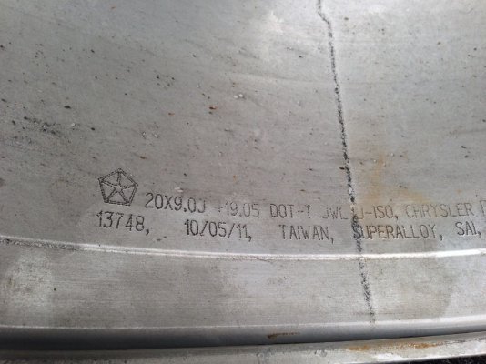

i thought the stocker 20x9s were +18/19?

The chrome clad 20's are a 9" wide wheel with 19.04 or 19.05 mom offset like fastnugly said and the non chrome wheels are 8" wide and not sure on the offset but its less.
The wheels you are looking at won't stick out too far at all
