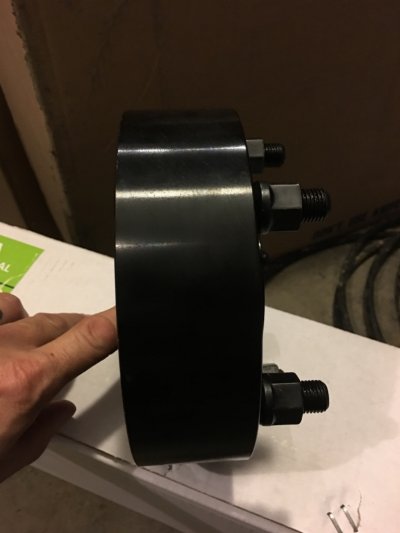

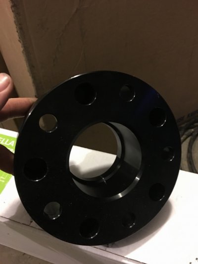

Spacers were finally delivered yesterday. According to FedEx tracking, they had been sitting in a distribution hub 80 miles from my house for the last 3 days.
Anyway, I only had time to open the packaging and snap a few pics. If the weather cooperates, I'll get them installed this weekend.

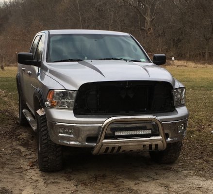

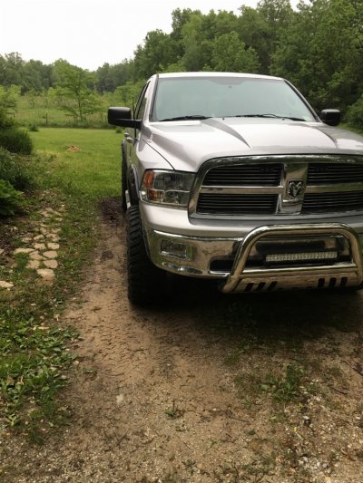

Got the spacers installed. 2" didn't push the tires out quite as much as I thought it would, but I'm happy with the result.
I think if it weren't for the flares, the difference would be much more noticeable.

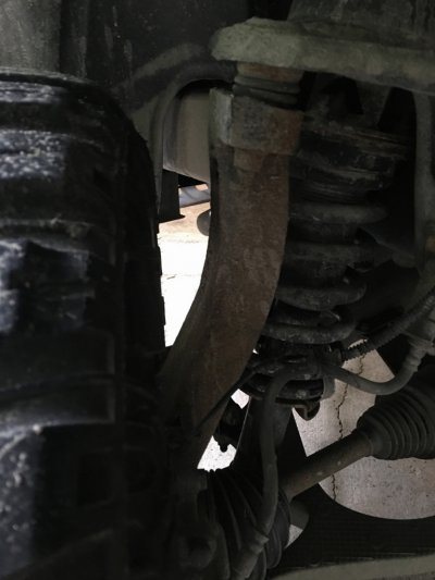

The big advantage though, is the added clearance between the knuckle and tire. Here's before, with the 1/4" spacers.
And here's with the 2" spacer.

Ya the flares really hide the poke. Trust me, they're out there.

It looked like I could have fit 1.5" without any cutting, but I'm glad I went with the 2". Tires are just slightly past the flares, but not so far that they throw a lot of stuff on the body. As an added bonus, I can now turn lock to lock without rubbing on the sway bar ends.
