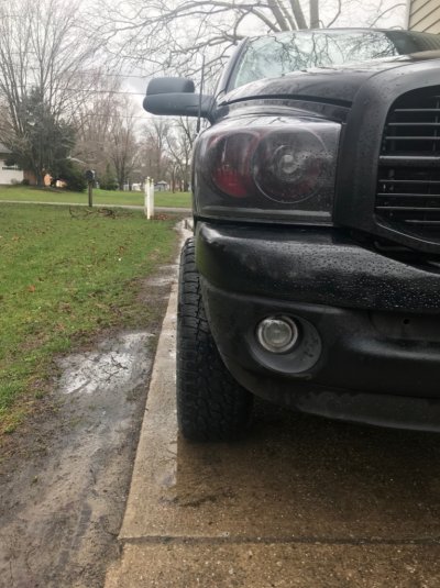

1-3/4” isn’t too much. You won’t have anymore issues then the same guy running larger offset wheels. When was the last time you heard of someone’s wheel just falling off? It’s the same thing, the spacers are lugged on just as tight as a wheel is. Buy quality stuff and you won’t have issues. I would say a 1/4” spacer wouldn’t make any visual difference at all. I’ve had my 1-3/4 bora’s for a year with zero issues, and I beat on my truck very hard 0df6ab66928ab2ccd8a1b5a24468a416.jpg

I drive the truck every day, usually about 12,000 miles a year. I haven’t had a single issue, honestly I forget they are on there

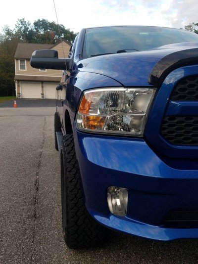

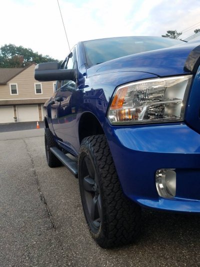

I used supreme suspension hubcebtric 1.5's with my stock rims. No trimming of studs because the stock ram 20's are recessed in between. I've had mine for about 20k no issues, I've since put flares on just because of the roads up here in the north east during the winter, install was easy! Cleaned the hubs, removed the rotor retaining clips,I blue loctite and torqued everything I believe so 120 ft lbs. Just note you will need two people to torque one to hold brakes while you torque the spacer studs on!7d06a8a22673bc7eda51c8d847629a1c.jpg5d30b28c2966a22fc36476840d50a6de.jpgdbff07581139bb728053bbfe015e45ef.jpg

That looks perfect. I live in N.J. so I’m sure I’ll need the flare too. What tires are those?
