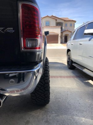

You can get some looks with spacers at customwheeloffset.com. BORA is the way to go. If you buy the BORAs from customwheeloffset, a rep will call you and ask for dimensions and characteristics of your wheels. It is up to you however to ensure they will fit (hence the gallery at the website!).
Good luck, and post some pics when you are done.
