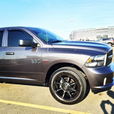

I have a 2015 Ram 1500. I recently put 20x9 fuel coupler rims on with a +1 offset. I used the factory tires which had 10,000 miles on them. I am now gettting a small wobble in the rear going 65 it goes away at 75. Can anyone think of why. The shop that balanced them said they are balanced good but the tire might have high spots. I don't believe them.
