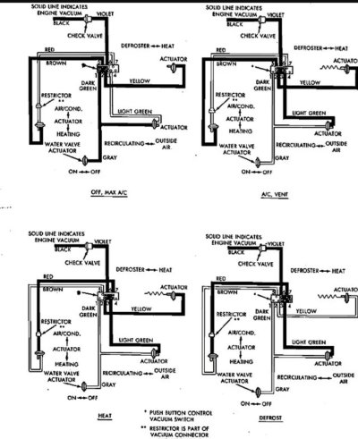

I ended up making my own with 1.5 inch vacumm line/tubing and so far so good. I found the schematics for the placement.
Thanks for replying!! It took me a good amount of research but now I have defrost. 1000008580.jpg

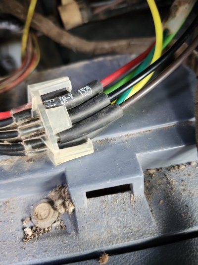

Here is what I used for the vacumm lines.
After I replaced the blower control switch and hooked up the vacumm lines it was like magic.
Oh, and vacuumed out the peanuts I found in the dash. Ha.
Good Luck!
