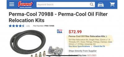

I saw a picture of someone with the 20-820 filters with a relo kit ... don't remember who had it
Not seeing where you see 3/4-16 on that at all? I did at one point. The pictures were more than likely mine... The first link I posted was the kit I used with the 20-820.

this is the one I originally bought. Stock filter
https://www.summitracing.com/parts/prm-70988
This is the dual version for the stock filter
https://www.summitracing.com/parts/prm-72988
