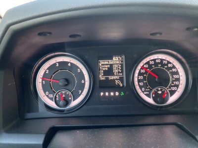

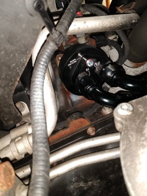

This is my current temps with the transdapt kit. And 190 engine coolant tstat. It’s mounted behind my bumper and gets cold air right across the filter. Running a royal purple 30-8a filter. Truck holds 8qts Of oil now as well

Is it necessary to upgrade anything with this kit?
The -10 (5/8") hose kit you were looking at earlier wouldn't be a bad upgrade. If you have access to a die grinder and a carbide bit and sanding cartridge roll it doesn't hurt to spend about 15 minutes cleaning up the casting flash and rounding off the internal sharp corners you can get at,i'm not a fan of any sharp edges in my oil system if i can avoid them,and they are a mass produced casting that are a bit rough around the edges,so a few minutes porting/polishing it doesn't hurt
Jan 17, 2016
23,714
54,457
14 Sport
If you do go for a remote filter,remember "out" from the filter adapter on the engine,goes to "in" on the remote filter mount,and "out" from the remote filter mount goes to "in" on the engine filter adapter.If you hook them up "in" to "in" and "out" to "out" you'll have no oil pressure,and you'll have to reverse the hoses on the remote filter mount.
