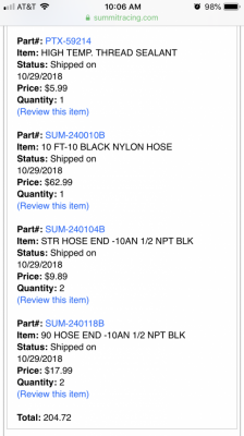

Do you have the part numbers, etc and vendor that you ordered for the -10an fittings/hose that you got?
-K
Permacool 70988 oil filter relocate kit and these were the rest. All from summit racing

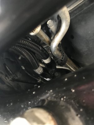

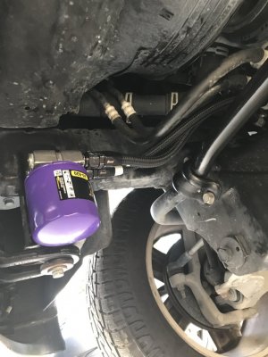

I was thinking about mounting the filter horizontally to make it cleaner to do, the oil can drain out right into the pan without getting all over the filter. Has anyone mounted theirs that way?
That I have done. May slide it up higher and add some kind of bracing to this for protection from road debris

^^^^^^ Nice. I am looking to do this next oil change so I have to get ordering.

So I think I'll mount the filter on the frame horizontally so it doesn't get all over the filter. It will be below the engine filter mount so it won't drain down when the engine is off. Anyone try that yet?
If you can find a top in filter mount then I don’t see why it would be bad. Less bends the better. I wanted a top in mount but couldn’t find one in the stock filter size.
