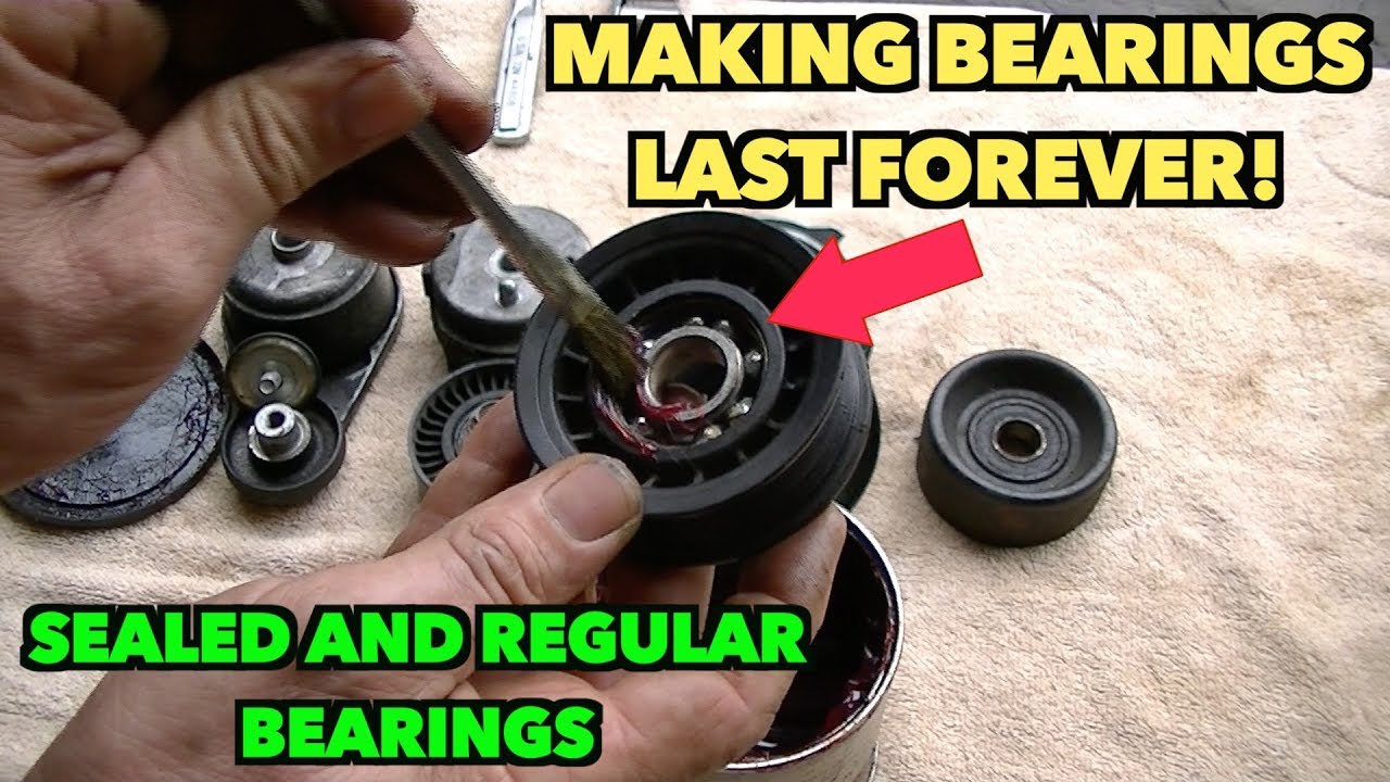

Since you have to remove the pulley anyway, a guy can carefully remove the bearing seal covers, flush it out, and re-grease. I've done many. It should be part of extended maintenance. They'll last forever if you regrease once -- esp if you do it before they start making noise. The grease gets old/hard/dry and they begin to make noise. I use mobil 1 grease when re-packing. The aftermarket pulleys I've used in the past didn't always fit right and were noticably cheap.
In some cases, with some companies (esp if a vehicle has a unique pulley) the aftermarket pulley is essentially the OEM pulley in a different box. But you never know what yer going to get for most vehicles till you open up the aftermarket box. The cheapies I've bought didn't last long at all (across the board, multi-makes). So I generally re-grease when I can or buy an OEM pulley.
