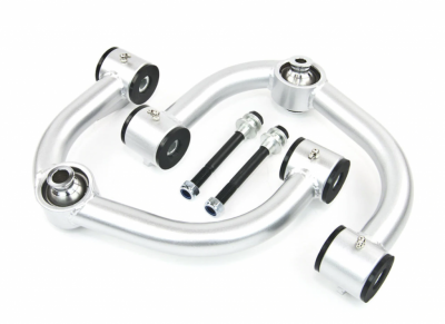

I put on "Pro Tune Suspension" upper control arms. Not cheap but no noise and has zirk fittings.

wow...they look nice too

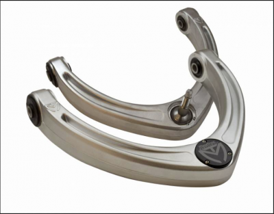

I intend to replace mine with a pair of JBA Offroad ones when I do my leveling kit install.
I’m happy with my decision to get the JBA. And just something to think about, you can get them powder coated for pretty cheap. I wasn’t a fan of the red for my truck.
What is your setup? Those JBAs look great. And red would be just fine on my Granite Grey Metallic. :)

Those don't appear to have any correction. Isn't correcting caster part of the appeal of the replacement arms?
Mines a 2wd, I have their spindles on front. Adjust fine with stock UCA, just want something more beefy.
I also have the same color truck as you, I think! I had them powder coated a semi gloss black. I have Fox 2.5’s with the coilover adjustment in the front and Fox 2.0 in the back. No lift in the back, but I have airbags for towing my toy hauler. And they work great. 3093970D-C793-41E9-B605-F119024201F8.jpegFAE0DC0E-30D9-4500-955D-6D7A70930DE6.jpeg175591FA-001C-4D66-A771-DF12F055C63A.jpeg
