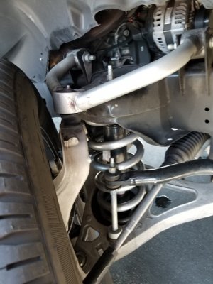

The OP question about Mevotechs. I have the CMS on my 6” Fabtech lift with no issues. The hell of a lot beefier than stock and works flawlessly! 2 years in July.
Also running their lowers as well. The TTX (I think that’s what their called, green anyways) are even better!
These arms are only for lifts that have the correct stock angle on their lifts or just stock replacement. Any type of a huge angle correction required, DO NOT run these and look for something like JBA, ICON, ROUGH COUNTRY...... and so forth.
