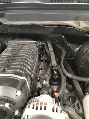

Can someone with a Whipple and a catch can post a quick pic? Thanks!

What are you wanting to know/see exactly? I can take a picture of my set up tomorrow.

Here is my setup with the Mighty Mouse can. The oil fill is now used as the inlet to the can hose runs around back to the can, then out of the can, under the blower to one of the ports on the blower. The pcv port has a pcv to 8an adapter that goes to the air intake and is used as the breather.
