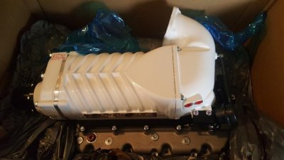

Not a bad way to spend 7 grand. I took a look at their website, is there an air to water intercooler into one of the manifolds to cool the air charge back down?
Yes there is a water to air intercooler. You can see the lower intake manifold, then the upper has the water to air intercooler. Has it’s own pump,radiator and coolant reservoir. Obviously the intake temps will be higher than a n/a truck but there not bad at all, even in the middle of the summer.

The whipple kit comes with an upper/lower intake manifold. Might be a hot air pump but hard to complain about an extra 150+ whp.
So you have had this for some time now. Have you done anything with the pistons, rods, crank, and transmission? How much boost are you running?
How does it perform as a daily driver?

About 3 years now, it has the drop in rod and piston kit from MMX now. Still running the 8psi they come with. Still performs great as a daily driver. It does drive different, the drive ability is not as good as a factory truck but that’s due to the vacuum based bypass valve. Sometimes you can end up in light throttle conditions with boost when you don’t want it. It’s a minor inconvenience though, it’s 100% worth it.
