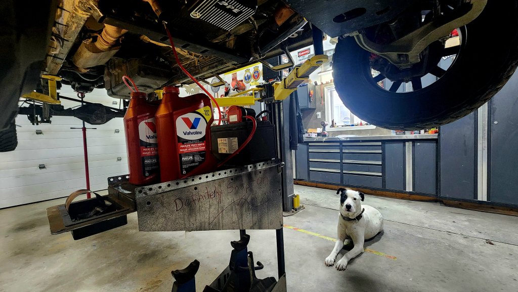

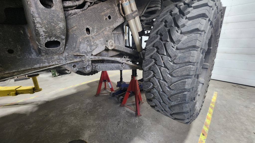

Hope you got your life insurance all paid up....... ;)
Looks like he has the front wheels blocked,so it's not going anywhere. You still haven't said whether you've done a brake job in your driveway with the vehicle on jackstands and the front wheels off,that's far more dangerous :Big Laugh:
The only time you're under it while it's running,is to check the fluid level, the truck is in park,and only idling,and like i told you before,if you're really worried about it falling off the jackstands put some blocks /ramps under the rear tires,so it can only fall an inch or 2 at most.
You worry way to much dude;)
LOL, that system of support he has looks like it could slip at any moment.
I've worked on cars and trucks since 1970, using a wide variety of lifts and jacks. I can quickly recall at least four separate lift-related incidents where serious injury, death, or complete vehicle destruction ALMOST occurred, but I/we got incredibly lucky each time. So yeah, I do worry every single time a vehicle is up in the air, and the concern is 100% justified.
And regarding doing a brake job in driveway while on jackstands, the answer is: nope, never done that...:cool:

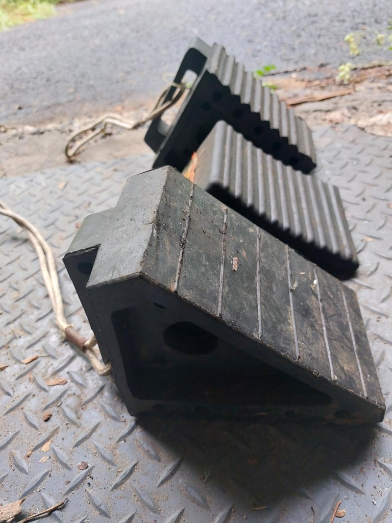

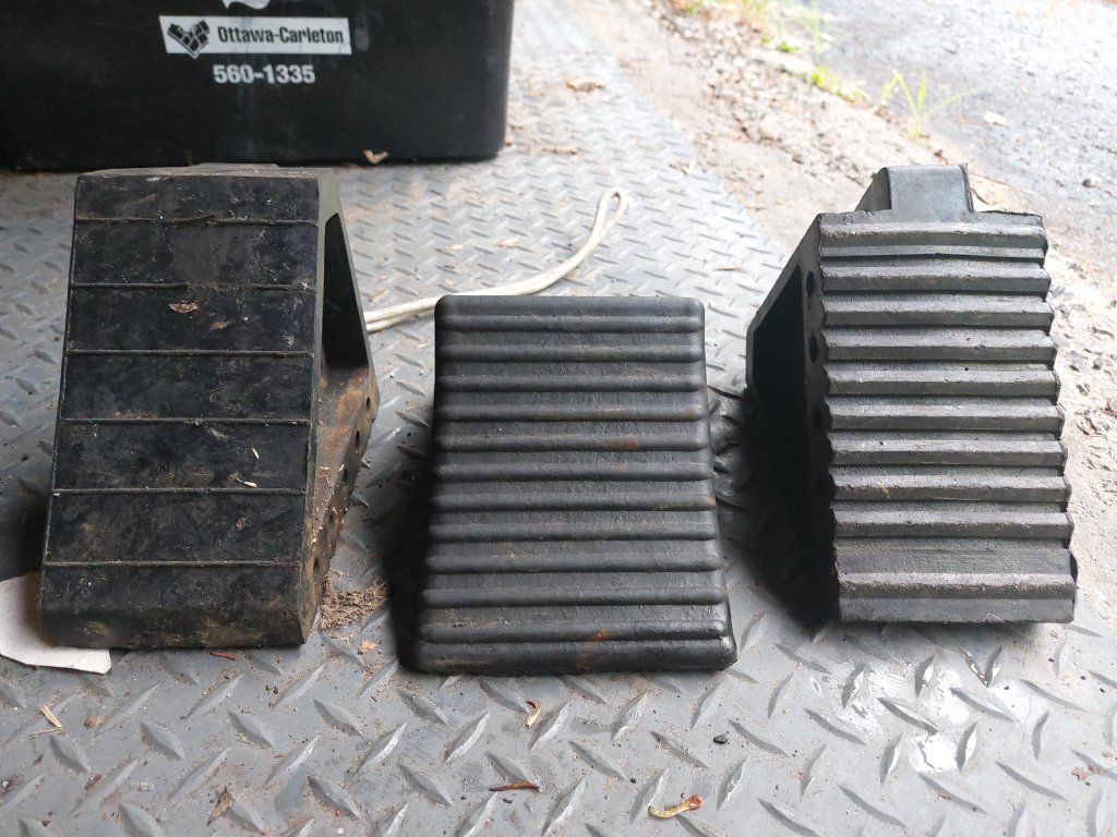

Dave, I'm always on high alert when jacking up any vehicle. And using jack stands gets the same attention.
The larger 6-ton jack stands provide more comfort than the smaller stands because they appear much more burly.
I just measured the height to be ~15.5" to ~22.5".
And, updated from 5-ton to 6-ton after looking at them this morning. :cool:
Using the smaller rubber wheel chocks helped with my comfort level while working on smaller vehicles, but I'm not convinced they're the best for trucks. They function OK, but not great.
I solved that problem by buying large rubber chocks. They're much taller and wedge more tightly than the little car-sized chocks.
Update; the large chocks are only about an inch taller but they function far better with larger tires than the smaller set I have. I've never had any movement with the large set and they're often a PITA to remove without moving the truck.
Very often, they're wedged in so tight that, after lowering the truck, they're difficult to kick out of place with work boots.
He could of used bigger 6 ton stands,but he's also got the floor jack still supporting the pumpkin to.You'd have to be way overweight for a truck to crush you with the tires still on it.
I've seen more cars fall off lifts then i've seen fall off jackstands when the wheels are propely blocked.
I'm gonna guess the 4 incidents you seen were cars falling off lifts and not jackstands right
Like i told you,if you're that worried about being crushed,put some blocks or ramps under the tires that are in the air,so it can only fall a couple inches
Yeah, yeah, I agree, the saving grace here is the truck sits high normally, and the tires are still on.
And you're right, all 4 incidents I've been around were with lifts; only one car actually fell off, but not all the way off.
