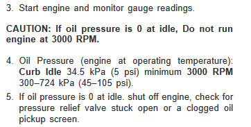

25-30 psi at idle seems dangerously low
That is not dangerously low for a stock 5.7 at idle lol. Gets lower than that if it's hot. If you think that's low this little snippet from the service manual will all kinds of p!ss you off lol:
Screenshot 2021-10-08 at 22-27-40 2006 LX Service Manual - 2006-LX-SM pdf.png
The 6.4 and 6.2 get such better pumps because 1) they are actual purpose built performance engines (sorry folks, the 5.7 from the factory is not lol) and 2) as actual performance engines they have piston oil squirters which require the extra oomph to move oil through the galleries and those too. Putting a better performing oil pump will never hurt things, but in the end it may not help either on a stock engine with all the extra pressure.
