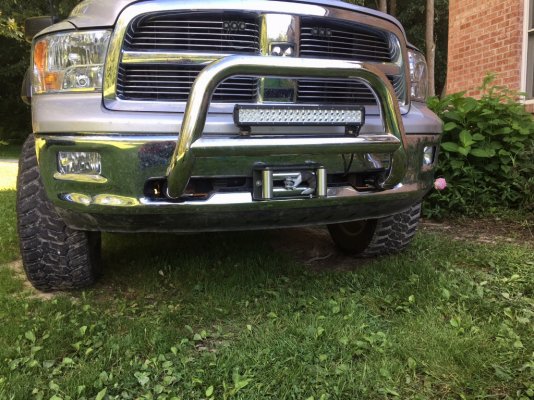

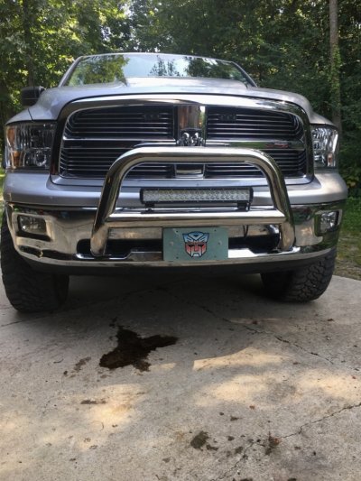

I've been thinking about doing something like this for my 15 ram 1500 sport. I've been hesitant though because of the way the bumper is and where the cable would be sliding out.
Iooked at some sport bumper pics. Looks like the overall shape is very similar to my big horn bumper. Even the insert looks to be the same shape. Shouldn’t be to hard to fine tune the height of the mount and fairlead to get the cable exactly where you want it.
Here’s a pic of where mine comes through the bumper.
There is enough space, that if you wanted, you could move the winch back, and keep the fairlead behind the bumper as well.
Or do like I did, and hide the rollers and hook behind a front plate.

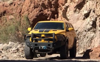

I have a 17500lbs winch on my ram. I like the bigger winch for a bigger cable[1/2 inch] and top layer cap of 11500lbs.Also draws less amps because it dosenot work as hard pulling. Its mounted in a very heavy duty trail ready bumper. Bumper and winch weight is over 500 lbs. truck5 (2).png 27750530_10155287568442963_6364894033296644869_n (3).jpg
