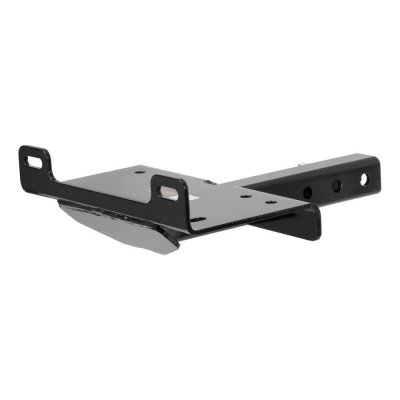

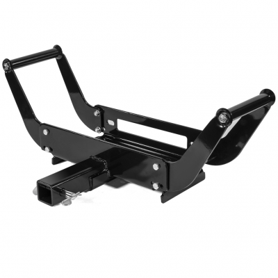

They make towing receiver winch mounts/cradles that can be removed and stored.

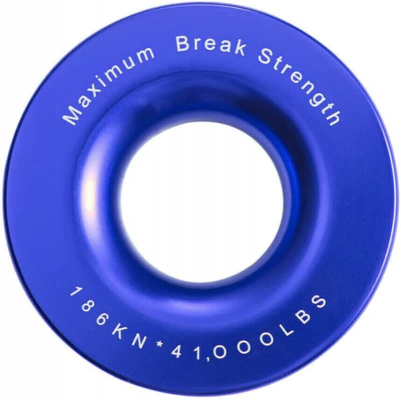

If I were you and wanted to mount the winch on the back, I would get a custom rear bumper made. If you actually plan to use the winch, putting it where the spare used to be is going to be a very inconvenient spot. It also makes winding the cable back on level nearly impossible. My winches are all front mounted, with three $natch blocks or $natch rings I can easily pull myself backwards if I want to. Have rarely had to do that in 50 years of off roading. I have always carried 4 off the rings and 3 of the full sized blocks but have only rarely ever used more than one or two of them.

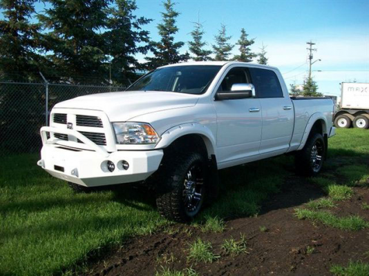

Check out Bullet Proof Bumpers out of REd Deer Alberta. Buying in U.S. dollars you save 30%. Excellent bumpers, you see them all over the oil patch up here because they are tough but still fairly light. My hunting buddy has one on his 1/2 ton and I am very impressed with it. He needed a whole new bumper because he had the painted factory one and it was chipped and rusted all to heck so figured might as well put a winch on at the same time.
If a hitch and the rear suspension attaches to the frame a winch could too, but it would take some Jerry Rigging.
Interesting point that if you're pickup is buried in the mud, perhaps a winch under it would not be desirable (although, better than nothing).
I fabbed up a similar receiver hitch for my trailer using a piece of scrap channel iron. Thus it is easy to mount, remove, and use independently from the trailer. I added two "D-Rings" to allow it to be used with straps or a chain. I haven't adapted it to use with the hitch receiver yet.

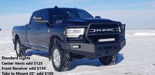

The only good looking bumper on our trucks is AEV . Those big bulky ones just add unnecessary weight to a 1500.

This is why you don't put Winchs under the truck. As to the Bullet Proof bumpers looking like they were made by a shop class, I have seen them up close, I like them. In my world, the actual functionality and standing up to hard use is the prime determinant of what we use.
