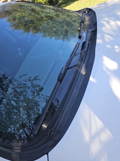

I have a 2014 Crew Cab LS as well, and it really ****** me off that there is absolutely nothing wrong with the cowling except for the rubber stripping on it! $300 plus because of a few dollars worth of rubber weather stripping? What a racket they have going. The engineers were not stupid....they made the gap from the edge of the cowling to the windshield further then most...meaning that most weather stripping at the edge of the windshield like this is 18mm, and it will not work. I am working on a method to just replace the weather stripping, if possible. Now, if the cowl itself was damaged, OK, still a lot of money for plastic, but I could understand that more. But not for this. This is a 'work in progress'

Hi, was wondering if you figured out a way to replace the weather stripping. I agree with you on this

I’ve seen a piece of molded rubber that does the job , but don’t remember where . Thought it was on this forum .
