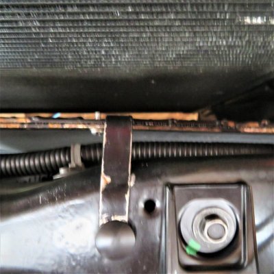

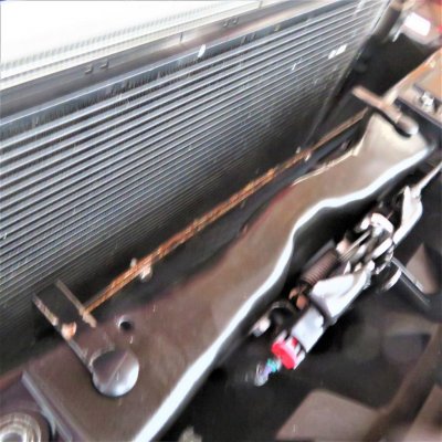

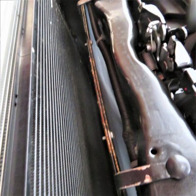

Open the hood, remove the plastic or cardboard cover that hides the back of the grille, radiator support, etc.
Just in front of the radiator there is a void.

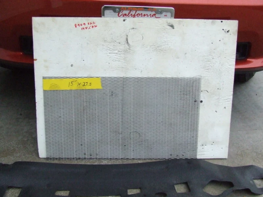

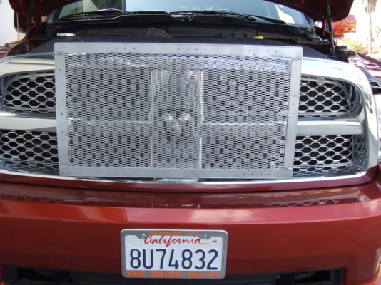

You could make a DIY winter cover

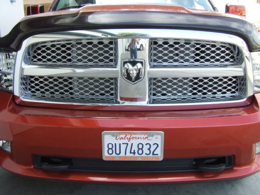

I made a DIY Bug catcher, to keep bugs & straw out of the radiators fins
Southern California has some large bugs & a bunch of Hay trucks
I seem to have lost several images, some of those were caked with bugs & hay
You could make something similar
just use cardboard or heavy cloth to make a useable shape

I forgot to mention,
I cut the expanded metal to size
I wrapped the edges with Corner Bead, when doing drywall at a corner, to protect the sharp edges, you nail corner board to the drywall, then you plaster over everything
We just folded the corner board over the sharp edges of the expanded metal
Then from Plumbers Strap, an L shaped bracket was made.
Then instead of bolts or screws, XMAS Tree screws were in line with factory holes in the radiator support.

My thinking mainly to keep the bugs out those fins in condenser, radiator, etc.
The bug catcher had to be removeable in a short time,
That is why i used the Xmas Tree plastic screws.
i could just grab the whole unit & lift straight up.
Using an Air Hose or even a water hose i could clean the bugs off quickly & reposition it.
A friend that owned a Audio & Alarm Shop, thought of the plastic screws & many other things, like where the CB is mounted
