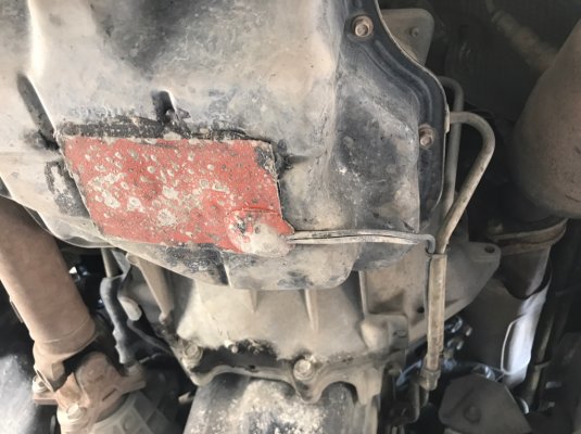

And i was 100% wrong... I do have a transmission pad! I know my old Sierra didnt have one for sure and just assumed the Ram didnt, but i got it winterized locally by my mechanic (for a steal) and just assumed. Maybe that's why it runs so damn well in the winter :roflsquared:

This is the pad of you are looking to do it yourself, I am in work clothes so I couldn't crawl too far without getting dirt/mud everywhere so I'm not totally sure what wattage it is
