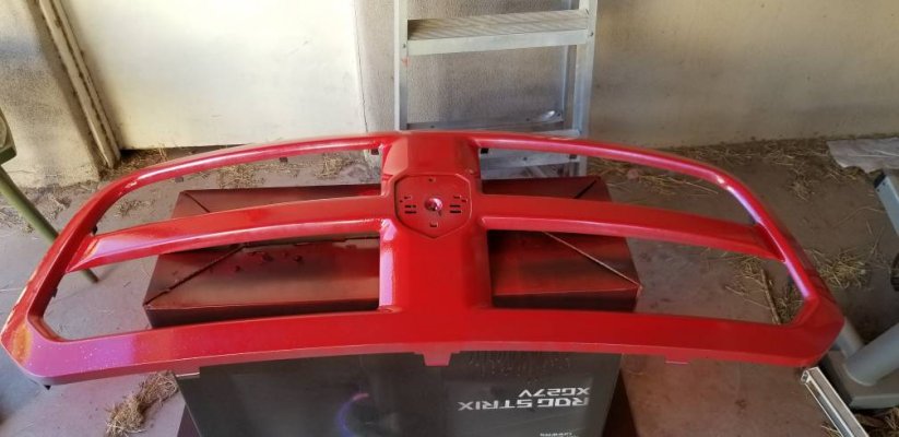

Decided to get rid of chrome grille... Depending on final outcome... Bumpers are next.30362dc5b0efc7cb8645695afb1524fe.jpg

As of now I'm a little concerned... My first coat appeared watery ... Have had can sitting for awhile. Thought I shook enough.. so with that said there's a bit of a run but hopefully I can get enough coats to cover it. Worst case... Clean off and go get a different color [emoji24]

Ugghhh, that sucks. I don't know how thick the runs are, not sure if you can cover it. Most important rules for using the rattle can.
1) Warm can in hot water between each coat.. I know, you live in AZ and its hot as hell, I would do it anyway.
2) Shake the **** out of that can for like a minute or two before applying each coat.
3) Spray first coat to just barely cover.
4) Clean that nozil like a dish you are about to eat off of before applying each coat. Alcohol works.
5) Apply lightly after first coat if necessary, who cares if it is 7 light coats instead of 3 heavy coats, spray at your comfort, avoid the runs. But, not too light to where it is too dry when it hits, otherwise it will dry rough and be a PITA to clean and will lack sleekness)
Disclaimer: That's the best basic info I got for a Friday night, probably could have done better on a Monday morning!

If it's all screwed up, don't be afraid to go nuts and blow another can on it before you rip it off. Trust me, if it's on too light, taking it off is going to be a circus! You'll be glad you blew another few bucks on it when your peeling it off.. That's some Monday morning advice right there!

Have the grill without inserts on truck bed curing in th sun
