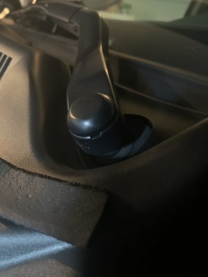

I just got a notice of a wiper recall. I think it only includes 2019 and 2020 Rams. Just thought I'd put this out there. I wonder if it's worth taking in? I'll look into it later, probably do it myself if the fix is just to tighten a couple of nuts.

So it’s not just removing that cap in pic and then re-torquing wiper nut? I know on my wife’s Durango it’s that simple but I’m new to RAM.

If splines dont match, or possibly stripped. i can tell you "tightening" is a very temporary fix. Go FCA.
If that is where the issue is,but if they need to replace any of the spindle assembly they need under the cowl cover,and if there's parts involved,i'm guessing they need under the cowl,as that piece the arm is attached to,comes out from underneath as far as I know

There’s no torque spec for the nuts in that recall. It’s literally remove the 2 caps off the wiper nuts and tighten nuts 90 degrees. No parts required or anything.

It’s for improperly formed splines of the head joint on the wiper arm.
