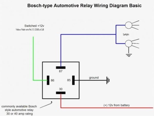

So then I'm assuming this is what I need correct? And hopefully this is the same thing? My local Oreileys has one.
So if thats what I need then what wires would go where? Keep in mind I'd still be using the ignition coil circuit in the fuse box which I guess which would continue to power the lights during the day when the headlights are off and I suppose in order to make the lights turn off when the headlights come on, I would use the marker light wire which is close to what @diymirage suggested, correct?

Using the example picture you posted above but instead use terminal 87a. The red would still go-to a fuse, the blue wire to the DRLs. The green and black wires would get wired to the running lights.
Wired this way will turn the DRLs off when your running lights are on.
Ok so let me get this straight.... The wire that goes to the DRL lighting would go to 87, the power supply wire coming from the ignition coil fuse tap in the fuse box (that I used the first time) would split off and go to both 30 and 87A and the wire coming from the marker lights would split off and go to both 85 and 86?
NO..do not use the 87 terminal at all.
The DRL wire goes to 87a and the supply power wire from the fuse tap goes to 30.
85 goes to the marker light, 86 is the ground (best to use the same ground as the marker light).

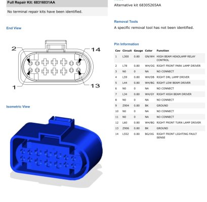

Ok, I think I got it now…lol. I guess it was the way you were explaining it that was confusing the heck outta me….lol.
But what do you mean by using the same ground as the marker lights? How would I do that? In order to get a wire from the marker light, I was just gonna pull the driver side headlight out and tap into the marker light circuit to run to the relay and just ground the relay to the chassis.
There is two wires(positive and negative) that go to any light bulb, same goes for the marker light. You'll run both to the relay (one to each terminal, not both together)
Technically the marker light will have three but one of them is the turn signal, don't use that one.

Well I guess I could see that if I had the plain reflector headlights but I have the premium projectors so then would I just tap into the white wire with orange tracer that goes to terminal 2 for the marker lights but which ground would I use? There’s 2- one that goes to terminal 9 and one that goes to terminal 13. IMG_0369.jpeg
either one should work but unplug the headlight and see which one shows the least resistance between it and terminal #2.
Just taking a guess it will probably be #13.
So you’re saying to unplug the big wiring harness from the headlight, turn the marker lights on and then take an ohm reading between the marker light terminal and the two ground terminals to see which one has the least resistance?
But just outta curiosity, why is this way better than just running a ground wire from the relay to a good chassis ground?
Take the resistance reading on the headlight pins, this is to determine which ground is the one wired to the marker lights.
Being all the bulbs are monitored, using the headlight ground wire there's less probability of problems with false bulb out errors occuring.
By that reasoning, wouldn't it make more sense to just ground it to the chassis or the battery ?
There have been members who have reported issues with wiring loads to a bulb then to a chassis ground.
In part it has to do with voltage biasing of the PWM circuitry that controls the lights on the truck. Where the ground path is referenced is important.
